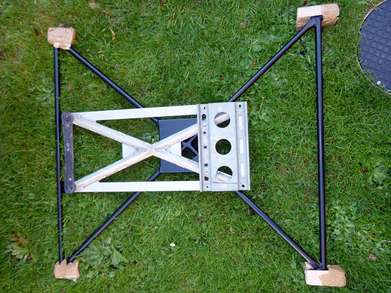

Here's a comparison from when I changed my Corky breastplate to Matt's brace, as you can see (and as has been suggested) they're quite different:
Sable 55 C-One MR2 C2 Turbo - A/C, Black Heated Leather, TTE Twin Exhaust, Cruise Control
jvanzyl
Wow - that's really useful! Didn't quite grasp the size of everything... what are your thoughts on the difference going from corky breastplate to matt brace?
